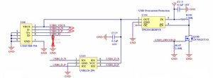

Can you share (offline) your baseboard schematic?
OÇ RE: Linux USB Gadget is not working on custom board - Added by Okan Çalış over 8 years ago
Do you see these lines even if you don't connect the PC?
Yes, I see those lines even when not connected to the host.
I did a dmesg in the Critical Link board, but those lines don't appear there (when not connected).
I have no idea if I have that kind of clearance; I must consult to my superiors first.

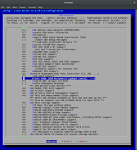

By default, CONFIG_USB_MUSB_OTG is selected which puts the kernel in OTG mode. In this mode, if USB*_ID is pulled low then the device enters host mode and if its left floating then its in Peripheral mode. An earlier design of our devkits had a pull down resistor installed which put the USB into HOST mode. This resistor R110 was not populated in later designs to fix this. See below.
If you do have this pull down in your design and you don't need OTG mode only Peripheral, you can change from CONFIG_USB_MUSB_OTG=y to CONFIG_USB_MUSB_PERIPHERAL=y which should cause it to ignore the ID pin and always use Peripheral mode.
See highlighted "Driver Mode"
If this doesn't fix things, the next troubleshooting step would be to measure the voltages on the USB pins when its disconnected and then when its connected and post them.
I consulted to my colleagues, who said the ID pin is already floating. Still, I tried forcing the kernel to peripheral mode, but that option seems to be missing in both menuconfig and the .config file.
Menuconfig screenshot
Another point is, the baremetal code that works gets the DSP core to use the USB, whereas I'm trying to make the ARM use the USB, and it fails (though it does work on MityDsp). Could it be because the ARM's having trouble accessing the USB?

Woops sorry I was looking at the 2.6 kernel sources. In the 3.2 branch Peripheral mode can be configured in the baseboard.
