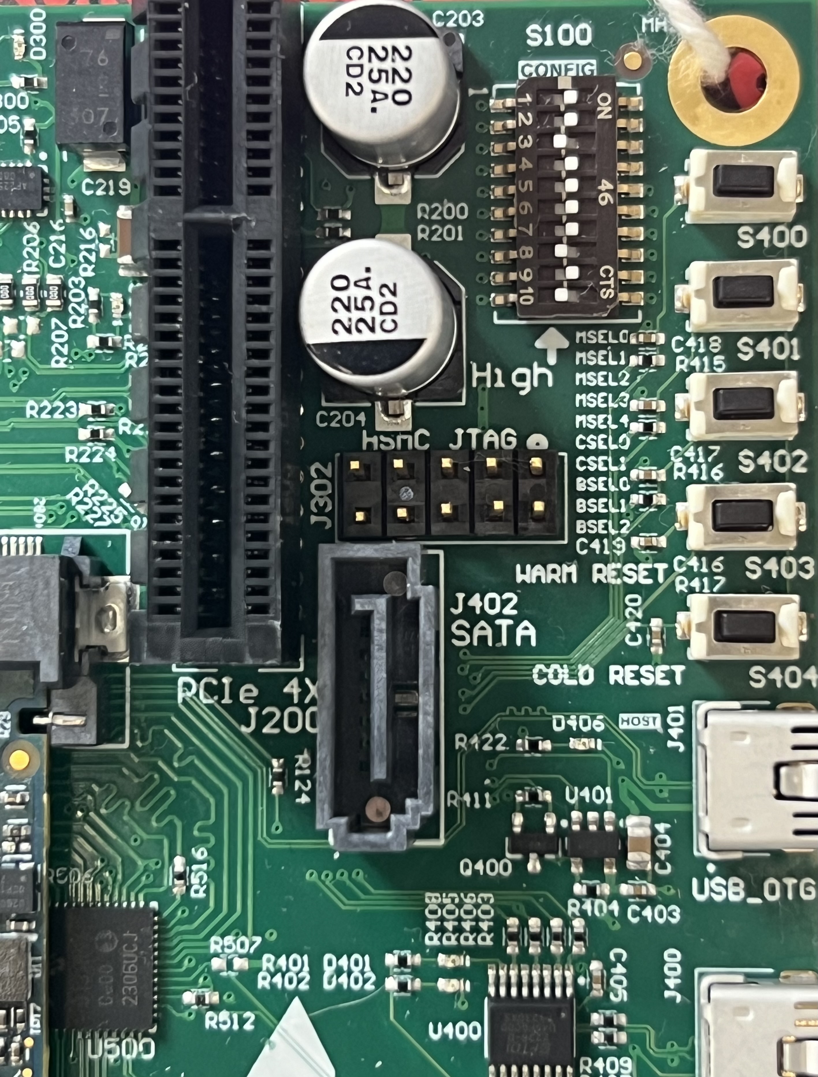

4-On the carrier’s DIP-switch block S100, the five MSEL switches are currently set as depicted on attachment.
Could you advise what might still be preventing FPGA-writeConfig from accepting the bitstream?

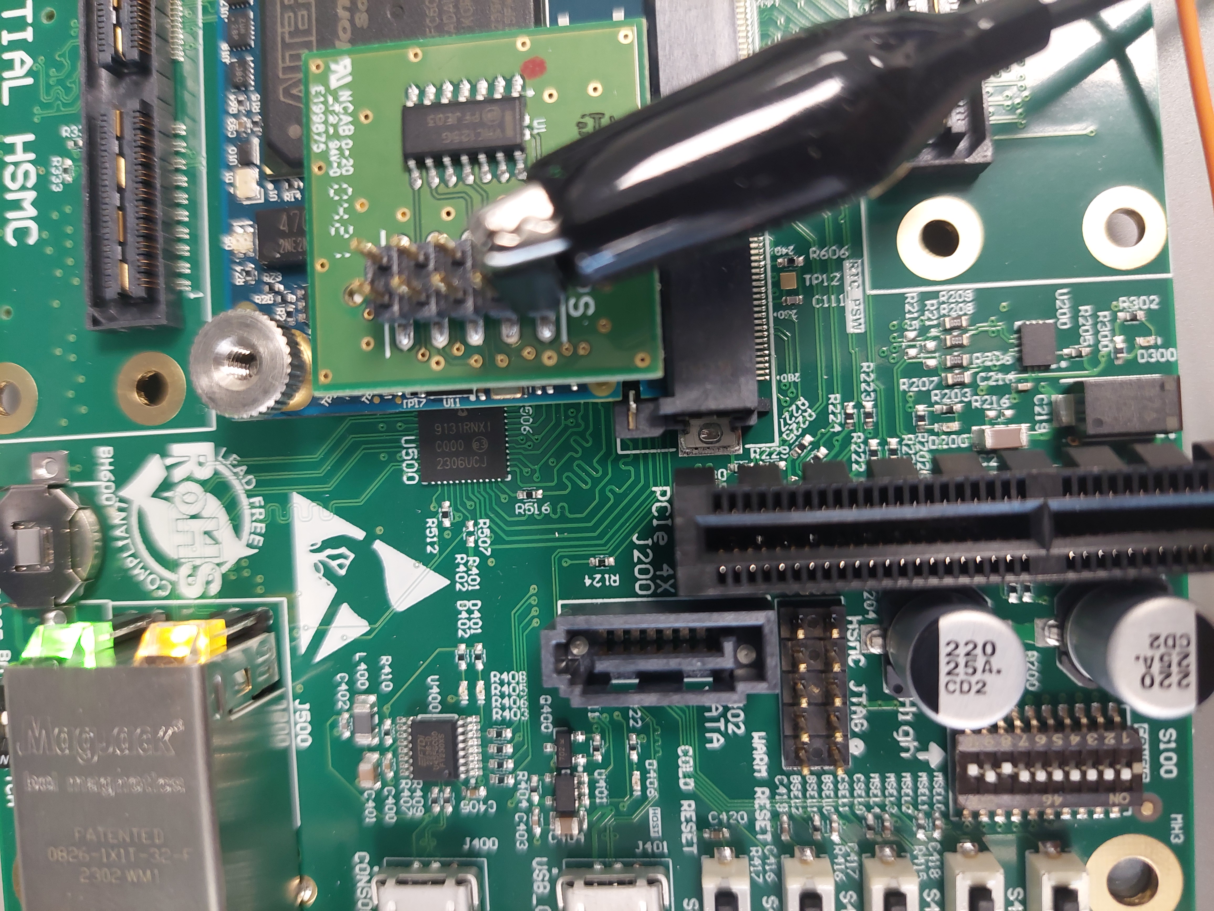

We were able to recreate your issue with the app you were using (https://github.com/robseb/rstoolsCY5). After compiling the app and running it on the board as you did, we were able to move past your issue by setting the MSEL switch as seen in the image below (the board must be rebooted or power cycled to update the configuration); however, this caused Linux to hang indefinitely as we have drivers interacting with the FPGA as it's trying to reconfigure. We recommend configuring the FPGA during U-Boot which is how the SD that ships with the devkit works. If you have any specific reason why you'd like to reconfigure while in the user space please let us know and we can take a closer look and see if we can get this working for you.
