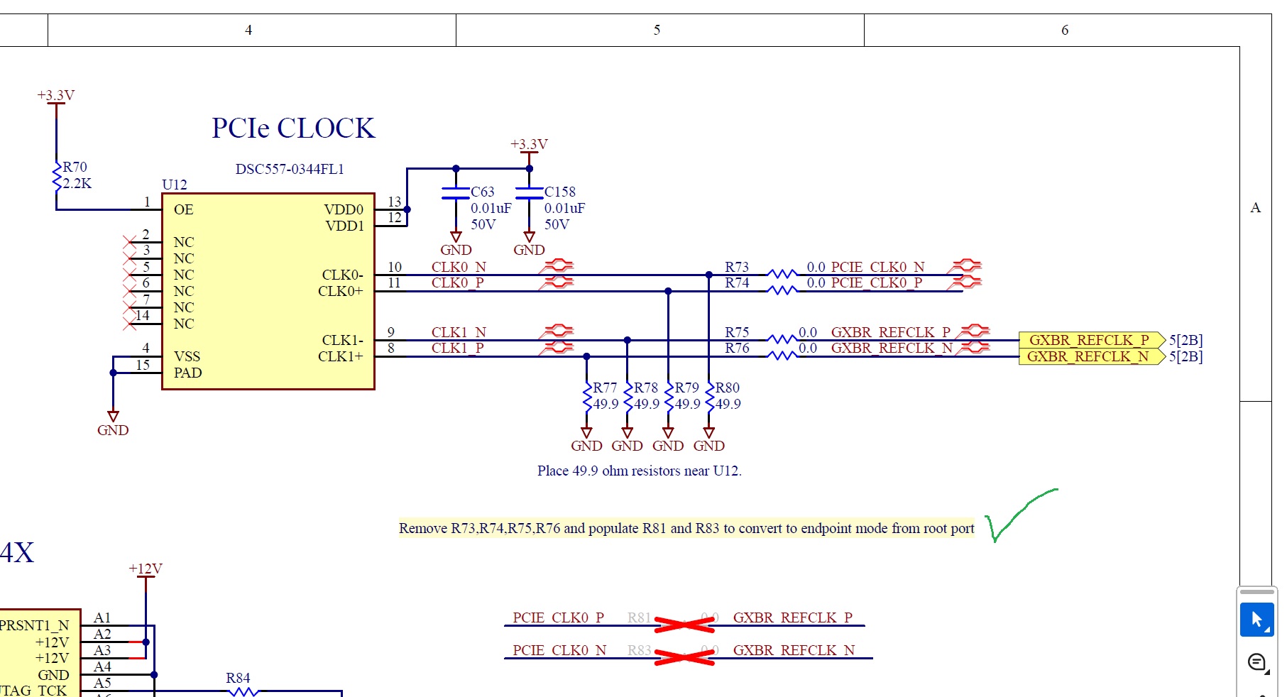

However, the PCIe REF_CLK may be sourced from the Critical Link SoM ... do we need to modify the SoM board to receive the external REF_CLK instead of sending one ?
Thank you,
Keith.
Replies (7)
RE: PCIe connection to Computer MB - Added by Keith Murison 10 months ago
okay I see there are some 0 ohm resistors to feedback the REFCLK+/- (PCIe_CLK) in end point mode... R81 and R83 on carrier board...
is this all that is needed to make the connection into standard motherboard ?

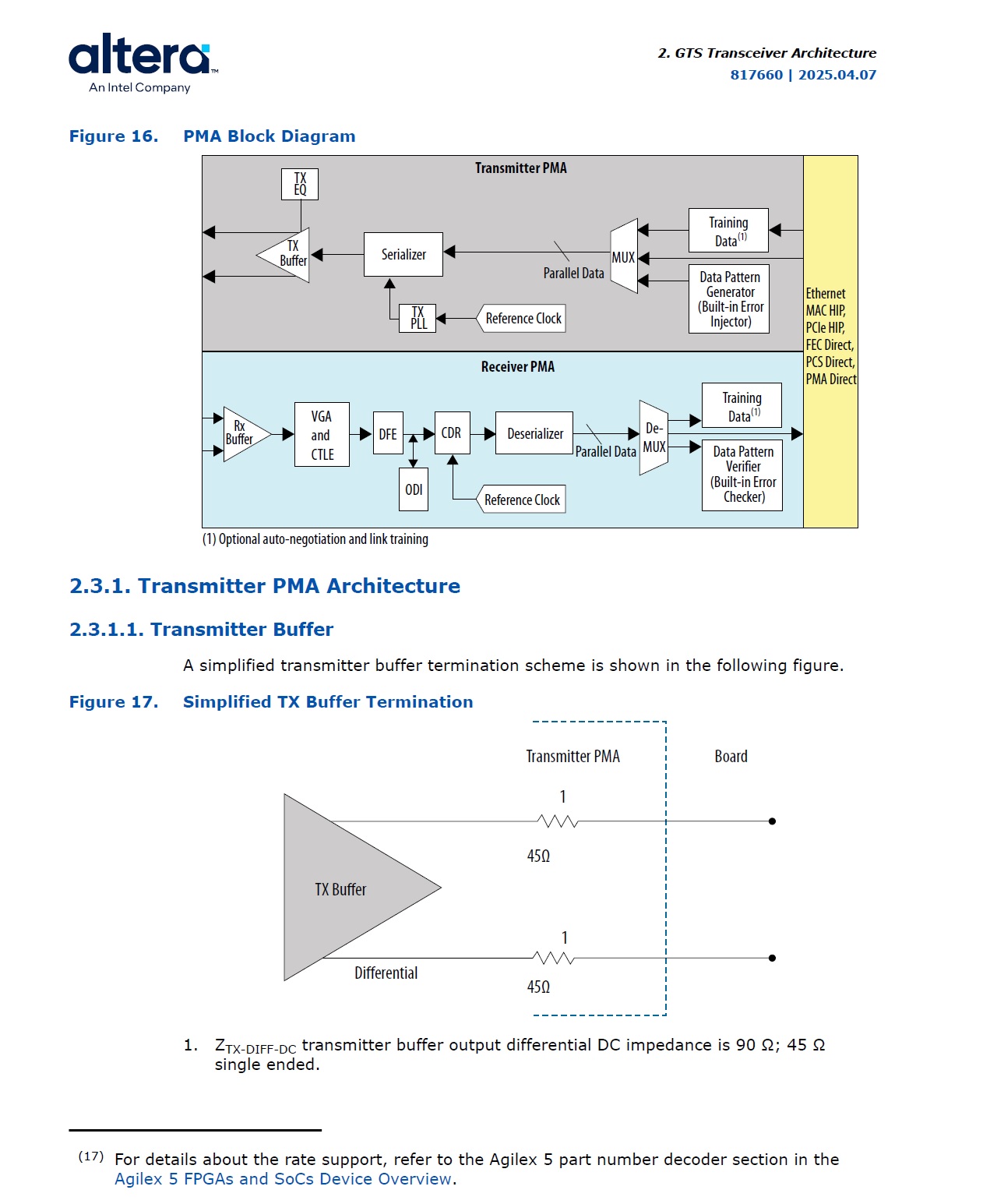

however I think the Tx and Rx lines need to be swapped w.r.t. the connector between EP and RP ... we cannot change the direction of the GTS signals on the FPGA.
can you please confirm this point ?
RE: PCIe connection to Computer MB - Added by Michael Williamson 10 months ago
Hi Keith,
Your concern is valid. You will need some sort of "cross-over" cable to swap Tx/Rx lines, etc.

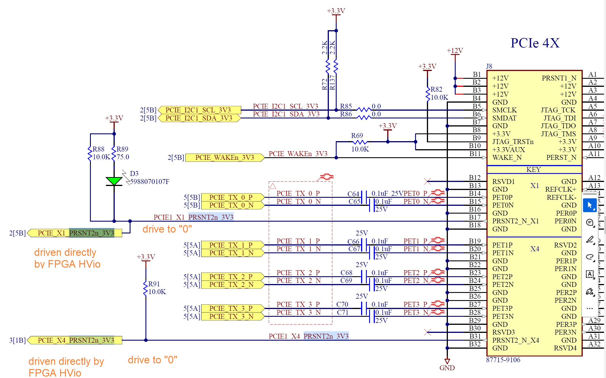

Actually, there is another issue, in EP mode, the Presecence signals, PRSNT2_*X1*# and PRSNT2_*X4*# need to be pulled-down by the Target/EP device,
however, these signals are pulled-up on the SoM, for the PCIE_X4_PRSNT2n_3V3 signal, we have a 10K pull-up, so it is okay for the FPGA to drive this to logic "0".
however for the PCIE_X1_PRSNT2n_3V3 signal, there is a 75 ohm and 2.1V 20mA LED: https://www.digikey.ca/en/products/detail/dialight/5988070107F/1291269

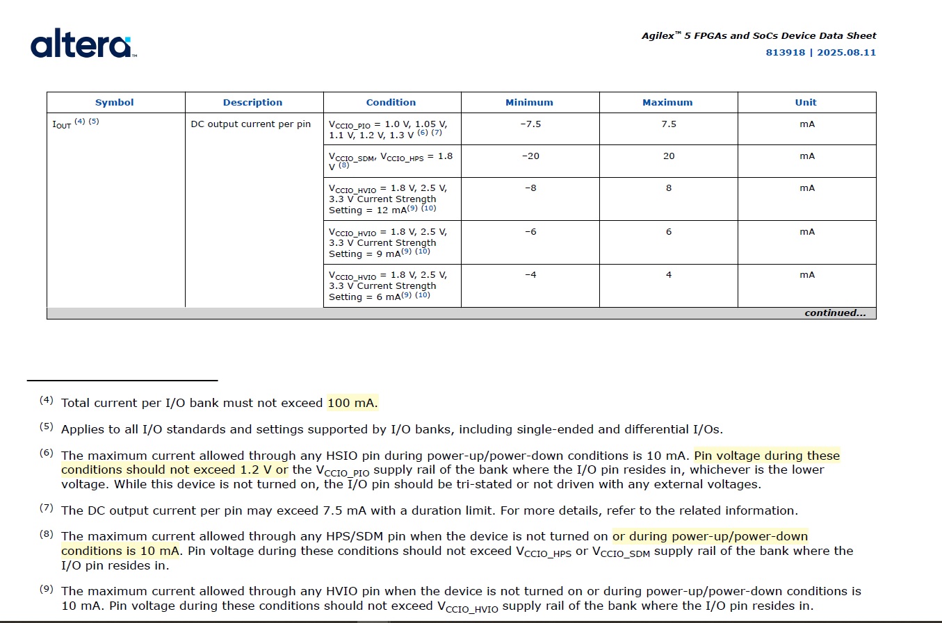

the maximum HVIO current for Agilex 5E is +/- 12mA .. so it may not be strong enough to pull-down this net with the LED diode in series...
worst case.. I think we can add a 100 ohm pull-down resistor to GND .. do you agree ?
Keith.
Hi Keith,
I don't think you can drive it in the FPGA (PCIe needs to be up fairly quickly and may need to be there before the FPGA fully configures).
I would just tie or (use on a 100 ohm as you suggest) both lines to ground and ensure those pins are configured as tri-state or no input.
-Mike
yes, actually it is worse than that.. the FPGA can only tolerate about 10mA, and must be less than 1.2V during power up ... so best to add 100 ohm pull-down to both these signals.
thanks,
Keith.
