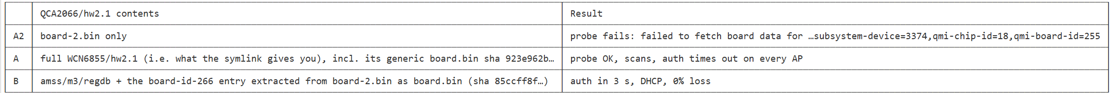

DC RE: SX-PCEAX-M2 (QCA2066) bring-up on BSP 1.2 and the QLI 2.0 prelim: two fixes needed out-of-box - Added by David Cuccia 6 days ago
Hi Greg,
Thanks for checking — so both our modules and yours read  board_id 0xff ; our lot-variance idea was wrong. To pin down the difference I ran a controlled A/B on a freshly programmed BSP 1.2-based image (same NM profile,  wpa-psk , regdomain US), bind-mounting three different  ath11k/QCA2066/hw2.1/  contents and reloading  ath11k_pci :
So the symlink works only because  WCN6855/hw2.1/  ships a generic  board.bin  fallback ( board-2.bin  has no entry for this card at board-id 255), and on our two units that generic BDF gives RX-only behaviour. Ours were −52/−56 dBm from the AP, so it isn't range on our side.
Two things that could explain why yours passes:
  1. your module may carry a different OTP calibration such that the generic BDF is "good enough" — could you check  sha256sum /lib/firmware/ath11k/WCN6855/hw2.1/board.bin  on your image and whether  dmesg | grep -i "board data\|board.bin"  shows a fetch from  board-2.bin  or the fallback?
  2. If you have a minute,  iw dev wlan0 link  and  iw dev wlan0 station dump | grep -E "signal|tx (bitrate|retries|failed)"  while connected would show whether TX retries are elevated even when the association succeeds.
Either way, shipping the board-id-266 BDF as  QCA2066/hw2.1/board.bin  in the BSP costs 60 KB and made both of our units work out of the box; we now build it into our own image. Happy to send the exact file.
