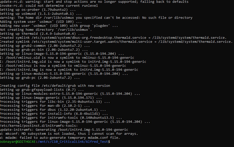

Can you please look at the attached screenshot to see if any of the messages at the end of the long make sd_image process mean anything negative?
Thanks.

MF RE: "Quick steps to Build" may be inaccurate in Building fpga 231 webpage - Added by Mike Fiorenza about 1 month ago
Bob,
The output attached appears to be of apt install linux-image-generic not make sd_image. If you're referring to the mdadm warnings at the end of the apt install, yes these are fine it's just stating that you don't have Linux RAID setup on your host (which is irrelevant here).
If make sd_image finished with "Generating .md5 file" and no make error with the sd_card.img in software/preloader then your image should be good.
