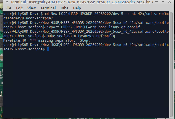

RE: JTAG_avalon_master access HPS DDR timeout - Added by Xiang Shuai about 2 months ago
Hi Dan,
please see attached picture, that's a typo when I fill this page.
BR,
Xiang
| clipboard-202602091046-ikfkk.png (166 KB) clipboard-202602091046-ikfkk.png | makefile |

RE: JTAG_avalon_master access HPS DDR timeout - Added by Daniel Vincelette about 1 month ago
Hi Xiang,
Sorry about the delay. It looks like this is either due to a missing or unexpected character in the U-Boot Makefile (around line 40), or it could be related to your build environment: it looks like you're using our Ubuntu 14.04 VM, which may be too old to build the newer example projects.
Can you please post your Makefile? Also, which branch of our Quartus reference design are you trying to use?
- 23.1-stable
- 18.1-stable
From your screenshot it appears you're using the Ubuntu 14.04 VM, which may have issues building these newer projects. We recommend the following Ubuntu versions:
- 23.1-stable: Ubuntu 22.04 LTS (this wiki page lists the required packages: https://support.criticallink.com/redmine/projects/mityarm-5cs/wiki/Building_uboot_231#Linux-Packages)
- 18.1-stable: Ubuntu 18.04 (the package list from the above wiki should also work)
Best regards,
Dan
