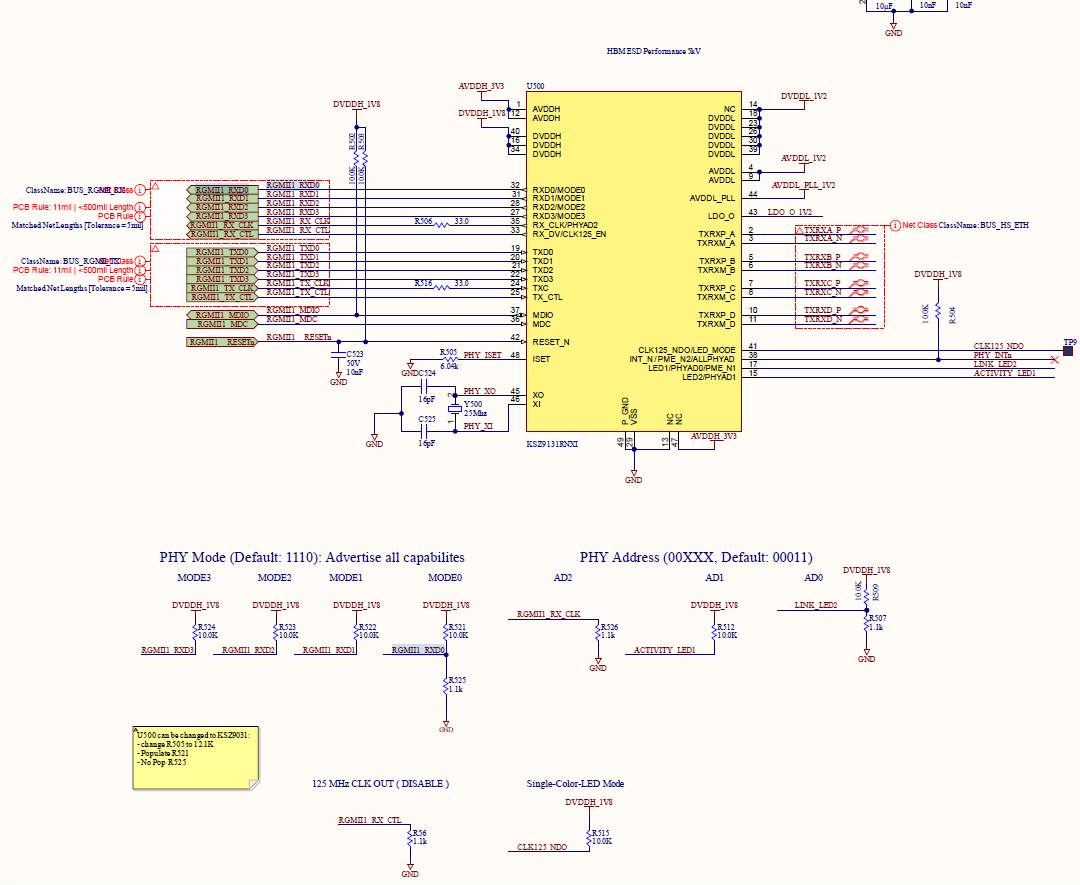

My custom carrier: same RGMII connections as the dev kit (clipboard-202512081603-uzgqp.png)
MODE0, MODE1 and MODE2 pins on the PHY are now strapped to match the dev kit schematic (same pull-up / pull-down configuration).

I ran ethtool eth0 | grep PHYAD on my system, and it confirms that the PHY is detected at address 3, as shown in the attached screenshot.
Could you please let me know if the Ethernet hardware section of my carrier board (PHY and RGMII connections) looks correct (R525 is not connected) ?
Also, how can I verify that there are no RGMII skew/timing issues in my hardware design? Do you have any specific checks or measurement methods you recommend for this?
Thanks

RE: Ethernet PHY configuration and SSH access - Added by Michael Williamson about 2 months ago
For layout, the two groups you have outlined in your schematic snippet should be matched in length and ideally be on the same layer. The clocks should be separated from the data lanes by at least 5x trace width. We usually use a 5mil matching rule for RGMII trace groups, with 50 Ohm impedance.
The PHY datasheet also has some routing rules regarding the ground plane between the PHY and the magnetics and Jack.
