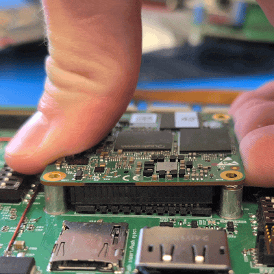

- The MitySOM-QC has three wafer level packages (outlined in red in the image below). Please take care to not touch or apply pressure to these packages when handling the SOM.
- Note that when removing the MitySOM-QC6490 the SOM should be removed by lifting up the left or right side first, as shown below. The Samtec SEARAY™ connectors can be "zippered" during mating/unmating.

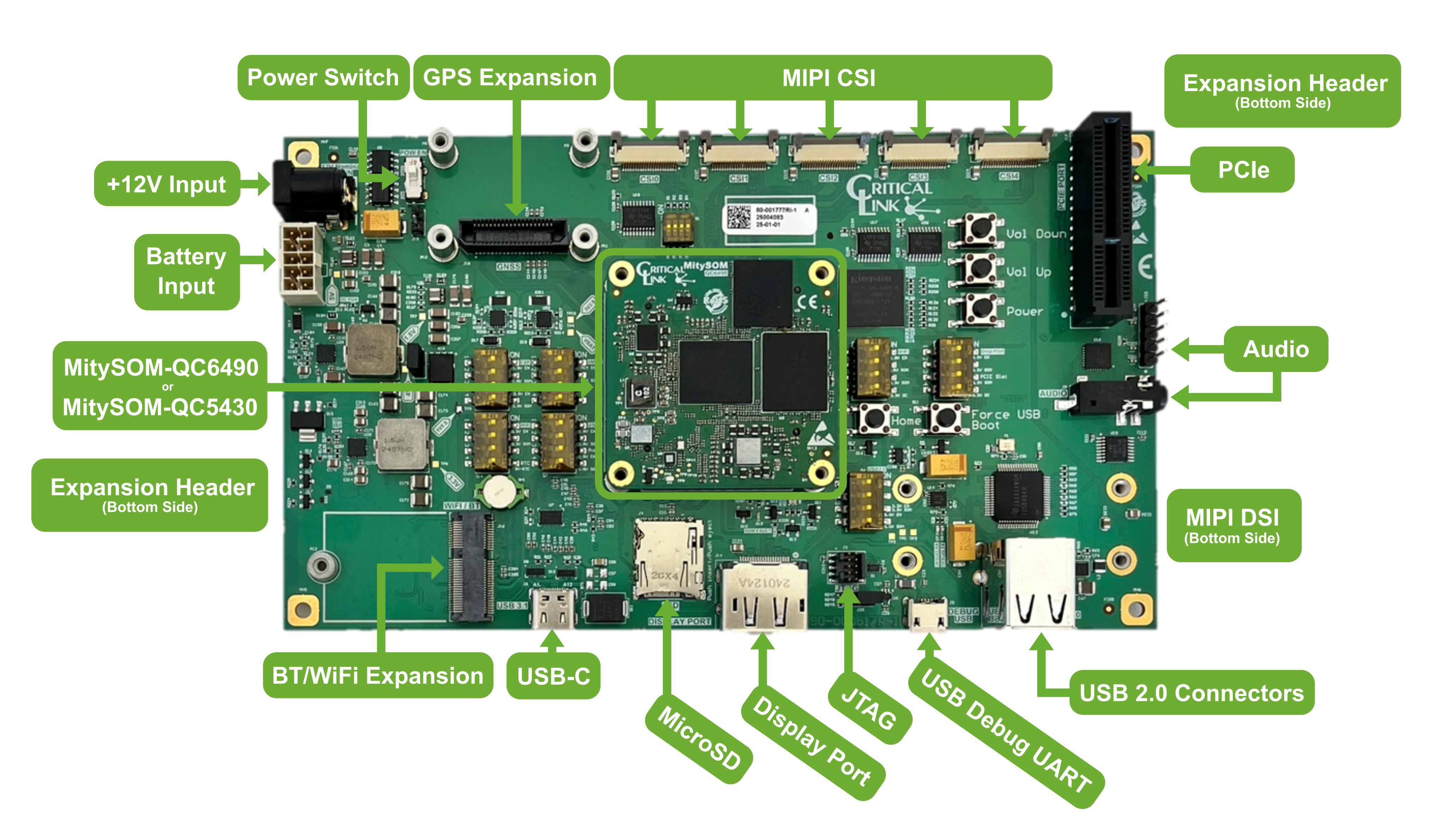

- Make sure Power Switch S13 is in the off position
- Make sure the Boot Mode Switches (S1) are set properly
- Currently all should be set to 0 as UFS is the only boot media supported at this time
- Make sure the Power Control Switches (S5-S10, S14) are set appropriately
- Please refer to the MitySOM-QC6490 Development Kit Datasheet for details on the supported switch settings.
- Connect the provided 12V Power Supply to barrel connector P1 on the top side of the development board
- Note: The provided power supply can provide up to 36 W. This is adequate for powering the MitySOM-QC6490 and most interfaces on the development kit. However, if a power hungry device is added to the PCIe slot a larger power supply may be required.
- Connect the development kit to a PC using provided USB micro cable to the USB Debug UART J5 on the top side of the development kit board
