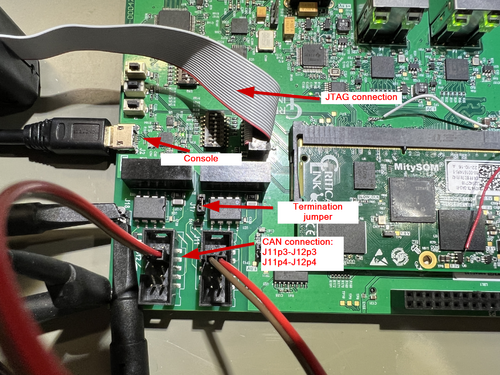

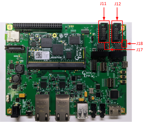

- Connect the mcan terminals with jumper cables as shown:
- Install one of the termination jumpers (J17/J18):
