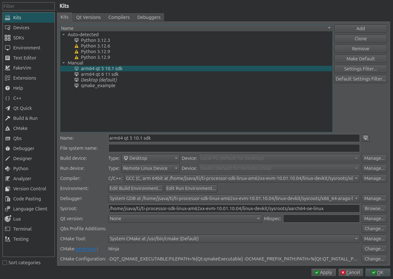

- Navigate to toolbar: Edit->Preferences
- Select the "Kits" category
- On the Kits tab hit "Add"
- Name: "arm64 qt 5 10.1 sdk"
- Build device: Type: "Desktop"
- Run device: Type: "Remote Linux Device"
- Compiler: C/C++: GCC (C, arm 64bit at /<SDK_INSTALL_DIR>/ti-processor-sdk-linux-am62xx-evm-10.01.10.04/linux-devkit/sysroots/x86_64-arago-linux/usr/bin/aarch64-oe-linux/aarch64-oe-linux-gcc)
- Debugger: System GDB at /<SDK_INSTALL_DIR>/ti-processor-sdk-linux-am62xx-evm-10.01.10.04/linux-devkit/sysroots/x86_64-arago-linux/usr/bin/aarch64-oe-linux/aarch64-oe-linux-gdb
- Sysroot: /<SDK_INSTALL_DIR>/ti-processor-sdk-linux-am62xx-evm-10.01.10.04/linux-devkit/sysroots/aarch64-oe-linux
- Qt version: "None"
- CMake Tool" "System CMake at /usr/bin/cmake (Default)
- CMake Configuration select "Change" and add the following lines
-DOE_QMAKE_PATH_EXTERNAL_HOST_BINS:STRING=%{Env:OE_QMAKE_PATH_HOST_BINS} -DCMAKE_NO_SYSTEM_FROM_IMPORTED:UNINITIALIZED=1
- Click "Apply" then "Ok"

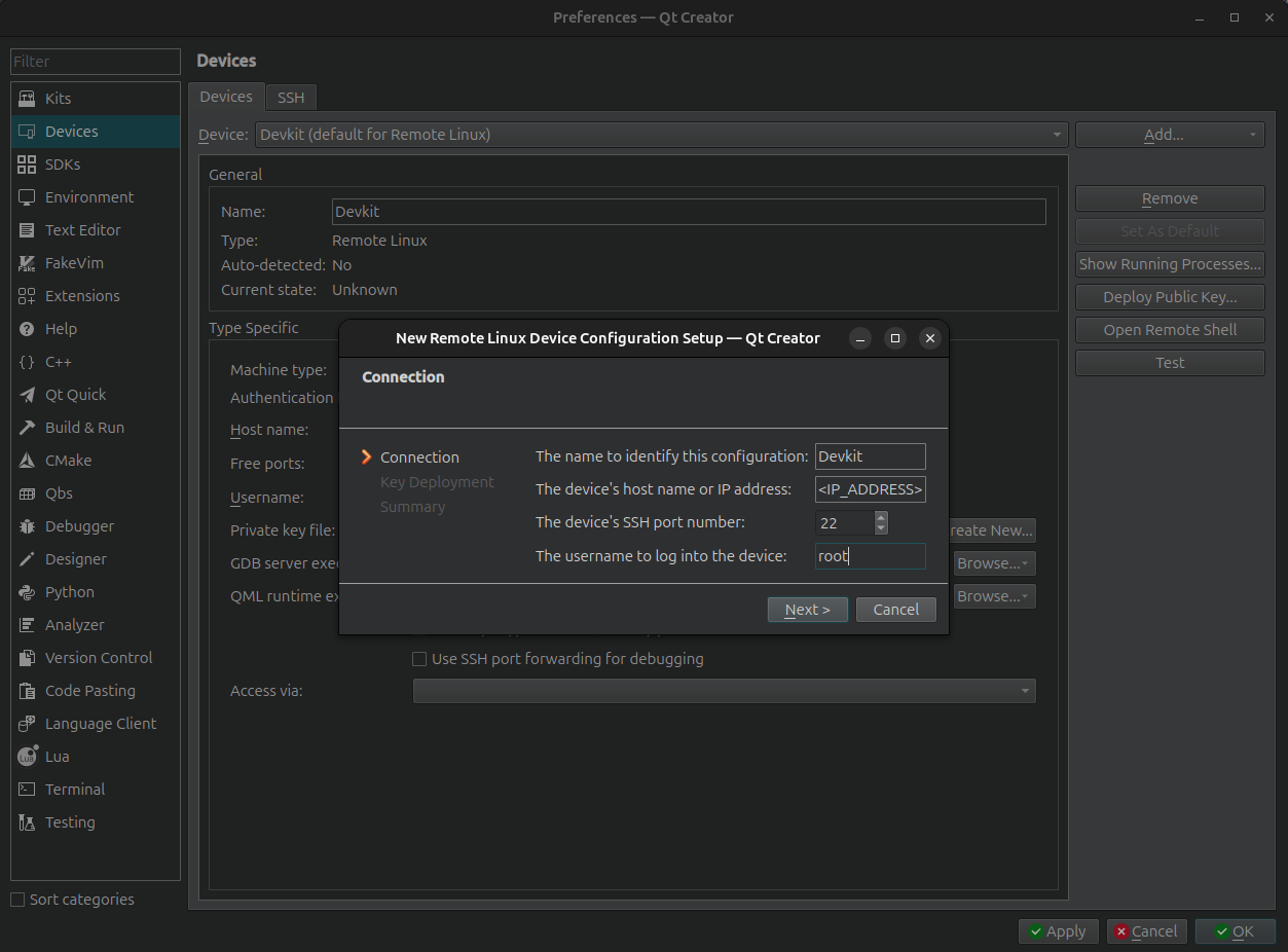

- Select the "Device" category
- In the "Devices" tab select Add->Remote Linux Device->Start Wizard
- The name to identify this configuration: "Devkit"
- The device's host name or IP address: <DEVKIT_IP_ADDRESS>
- The username to log into the device: "root"
- Hit "Next" until it prompts to "Finish" the creating the device
- Device test should finish successfully

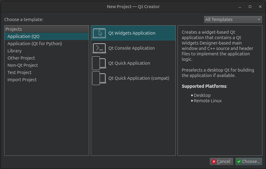

- Navigate to toolbar: File->New Project
- The following window should appear. Select "Qt Widgets Application"

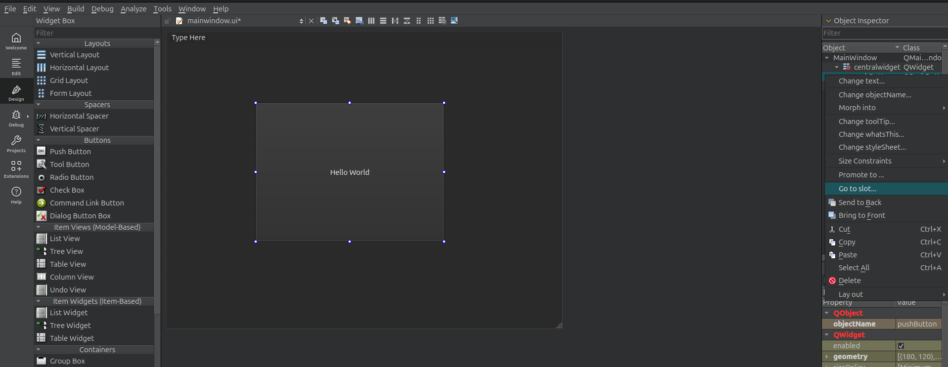

- Select hello_world_gui->hello_world_gui->Froms->mainwindow.ui
- The "Design" Tab should now be open
- Drag and drop a "Push Button" into the window
- Navigate to "Object Inspector" on the right hand side of the screen
- right click on "pushButton" and select "go to slots"
- Hit "ok" in the pop up window

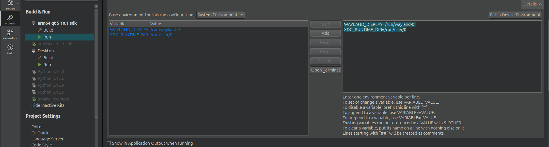

Add Environment Variables- Qt Creator needs to know the following Environmental variables in order to launch on the Devkit
- In the toolbar on the left hand side of the screen select "Project"
- SDK 10.01
- Under "Build and Run" select arm64 qt 5 10.1 sdk->Run
- In "Run Settings" find "Environment"
- Select Details and add the following
WAYLAND_DISPLAY=/run/wayland-0 XDG_RUNTIME_DIR=/run/user/0
- SDK 11
- Under "Build and Run" select arm64 qt 6 11 sdk->Run
LANG=C.UTF-8 LC_ALL=C.UTF-8 QT_QPA_PLATFORM=linuxfb

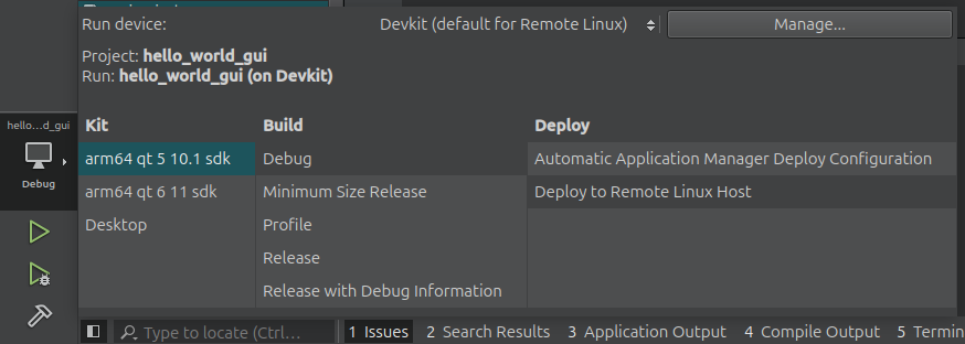

- In the toolbar on the left hand side of the screen navigate to the monitor icon with "Debug" below it
- Double check that the correct kit is selected
- Select the green launch icon below the monitor icon
