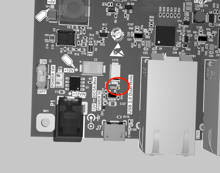

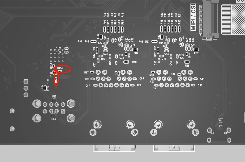

USB HUB wakeup source on DevKit
In addition, for the current release of the DevKit, the USB port that is connected to the HUB (USB1) must be disabled in order to enter and remain in sleep mode. Currently there are pullup/pulldown resistors on the DevKit on the USB hub interface that must be removed / altered in order to clear this issue. A note and errate for this issue will be published when final details are available. Please contact critical link for more details.
